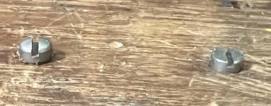

I have a bunch of side plate screws so I screwed them in after drilling 7/64" holes in wood and filed one down. One is still OEM.

Other option is making the screw heads flat. Just did one to see if the remaining slot is usable.
