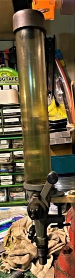

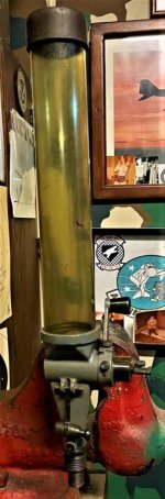

Bought this at a gun show this weekend. Mainly wanted the box that it was sitting for my collection. Paid $20.00 for the box and #55. Have never seen a powder hopper this big. Can anyone enlighten me as to why it is so large?
Thanks,
AJ
I can only guess... perhaps due to dispensing large charges for some magnum cartridge... a previous owner got tired of having to frequently refill the standard factory hopper and replaced it with a ridiculously long piece of clear PVC tubing.
There was, of course, a version of the No.55 available from the factory with such a large hopper (the No.55 Classic), but those hoppers were made of aluminum, for use with Black Powder.
Jim
Sinclair International sold replacement "Hoppers" in lengths up to 10 or 12 inches. The only Lyman hopper that was anywhere that tall was the Black Powder variation and it is not clear but is made from aluminum.
The taller the hopper the more it holds. A regular 4" won't hold enough to do 200 338 Lapua at 104.0 grains of US869 or other Elephant cartridges.
The long Range Black Powder cartridges like the Matthew Quigley Sharpe's 45-110 only get 63 rounds to a pound of powder. My 338 Lapua Mag uses 104.0 grains of Hodgdon US869, that's about 65 to the pound. The long aluminum hopper holds a full pound of FFg BP. The short hopper holds about 2/3 pound US 869.
Obviously these are huge cartridges, but when loading large capacity cases it uses powder very fast. If they used the powder measure for shotgun loading, that uses large volumes of powder too.
If you look at the powder measurers for progressive presses, they have hoppers like this or even larger.
Jim
Hard to figure why it is that tall; maybe for effect or maybe for charging .50 machine gun brass.
However, if you're throwing big charges for magnum rifle cartridges, say more than 70 grs., a regular powder hopper is depleted pretty quickly. But it requires little time and effort to refill.
