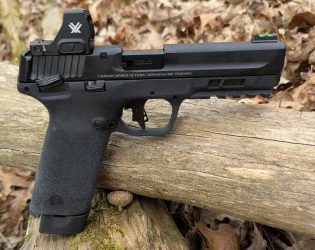

I finally got my Vortex Defender CCW mounted Saturday and hope to get it sighted in later this week.

This afternoon I took a quick trip down to my range to sight in the 3 MOA Vortex Defender CCW.
Again, I was using the Federal bulk.
I ended up shooting 188 rounds of the Federal bulk and I had a handful of times on one magazine that the the first round didn't have enough power to eject the fired case and chamber another round.
It was always the same magazine.
I fired five rounds of CCI MiniMags in each magazine and they both worked fine.
It will require further "testing".

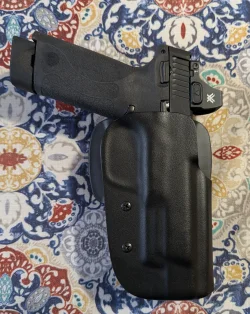

I tried my M&P40 PC Ported's CompTac Flatline and my BladeTec M&P9 Pro IDPA holsters.
While certainly not suitable for any fast movements with the gun holstered either is sufficient for careful range time.
The BladeTec holds the grip away from the body more and make presentation smoother.
That's what I have used on my M&P22 (not compact) for about 13 years
