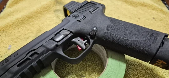

I can confirm that the Galloway Precision 22mag/5.7 trigger will work in the 22x. But be advised the 22x comes apart much differently than the 22mag so use GPs video as a basic guide and pay close attention to the trigger reset spring orientation.
    541.2 KB
How much improvement did you get from the Galloway trigger? Any reliability issues with it?
Thanks.
An update.... while the Galloway fit and technically function in the 22x i experienced multiple fail to feed and fail to fire using the Galloway trigger, no adjustment to the reset had any effect on the reliability issues. It acted like something in the trigger was slowing the slide down and causing the fail to feed.
Reinstalling the factory trigger removed all issues and returned the reliability the 22x has demonstrated over about 2500 rounds thus far.
