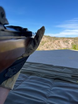

Here's the Springfield at the long range steel course where I shoot.
