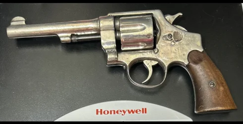

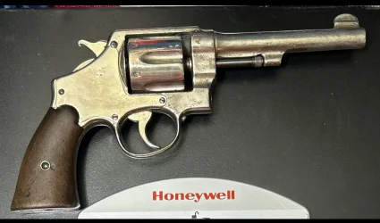

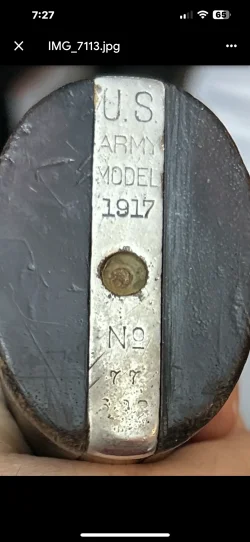

I inherited this M1917 from my grandfather, who has since passed, and want to know more about it. Any info is greatly appreciated. I was thinking the finish was nickel but it seems awfully shiny. Butt # looks to be 77693.
There is both good news and bad
The good , its a cool heirloom of US issue 1917, hang on to it for nostalgia. Made in 1918
sadly, the bad news... it been nickeled and a poor job was done.
The Gun was pitted and then buffed over , hammer & trigger are nickeled and the swivel is missing.
United States Property is buffed, almost erased, I think I can barely see what's left.
Others way more knowledgeable than me may chime in.
Butt # looks to be 77693. Note: the one in my avatar is 77666 1917 R.webp
It's been refinished at some point in it's life. The factory never produced any 1917's in nickel for the war effort. A dead give away is the
nickel finish on the hammer and trigger. Also the grips are a mis matched set. The left panel is from production in late 1917 to early 1918. Based upon your serial number that revolver was probably made mid 1918. I could be wrong. Look on the right grip panel, see if there is serial number on it that matches the butt serial number.
Not much in the way of collector value but probably a good shooter.

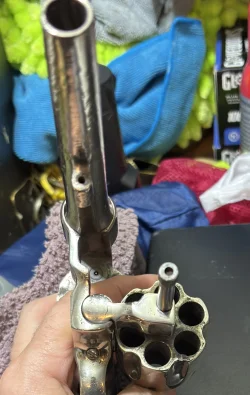

How is the barrel bore condition? If OK, the gun will still be fun to shoot no matter what it looks like. It's more fun than just hanging it on the wall.
I see that the original style extractor rod with mushroom shaped knob has been replaced with a blued post 1929 version with the barrel knob.

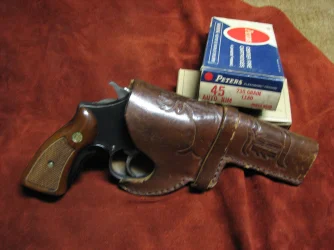

.45 Auto-Rim works well in a 1917-type revolver. They do eject. I personally use the Full-moon type clips in my 2.5 inch. Those hold all 6 rounds kind of like a Speedloader that stays in the gun. If you use those, you will want to get the tool from Brownells to help extract the casings from the clip after firing. It will keep you from tearing up your hands and uttering words that would make a Sailor blush.
