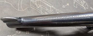

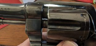

The "NOT ENGLISH MAKE" would have been applied when the gun was released from military stores and went through the Proof House to prepare it for commercial sale. Wartime Lend/Lease guns were technically still US property but unlike later (Cold War Era) guns they seem to have been sold off as surplus by the countries they had been supplied to instead of being reclaimed by the US government (such as the many guns that have been returned and sold through the CMP over the years).
PS: Guns imported for commercial sale would have to go through the Proof House before they could be sold. Guns supplied to the military would receive a military inspection but would not go through the commercial Proof House before military use.
If I'm reading this correctly, this sounds like a 455 Mk II. However, it may have had the cylinder reamed or shaved to shoot either 45 Colt or 45acp. This does not sound like a USGI gun to me. The 1917s exported to Brazil in 1937 & 1946 are chambered in 45acp though. Happy hunting!
Actual 45 acp barrel + cylinder...fair price.
Converted .455... that's a pass.

Seller tells me timing and lockup good. Tight cyl gap as seen in photo. He sees no evidence of it being a former .455
He has shot it the range 45ACP.
