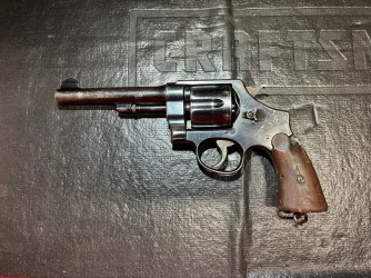

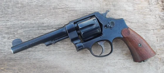

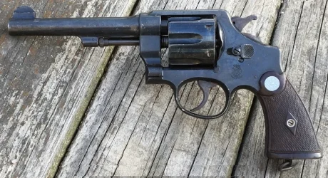

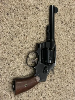

Here's a picture of my Brazilian range fun-gun......

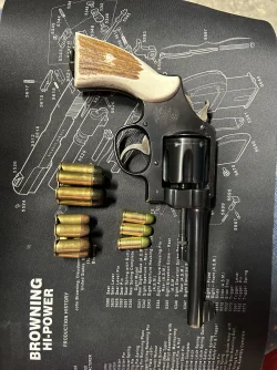

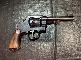

and here's a picture of a safe queen that doesn't get out much......

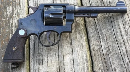

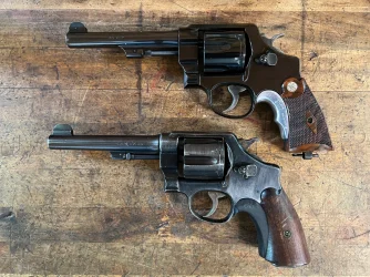

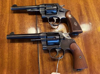

Here are mine - a Colt (bottom) from 1919 and a S &W transitional commercial from 1947.

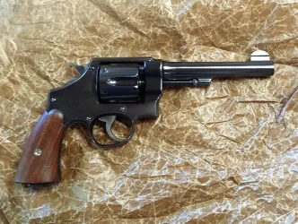

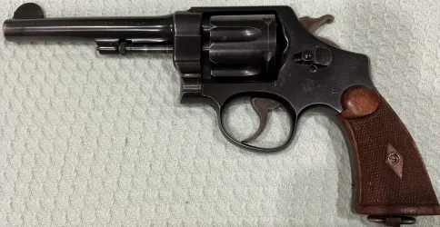

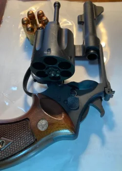

S&W has made a variety of ACP revolvers starting in 1917 with the 45 Hand Ejector Model 1917. Just staying with fixed sights, there is the Model 1917 Army, 1917 Commercial, the updated version - the Model 1950 Army and finally the modern version of the Model 1950 Army - the Model 22-4. I like them all.
Kevin

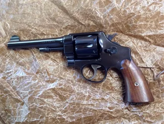

    1.2 MB
I just looked at it now. It shipped in July 1946. No S in the serial and yet I have data for Model 1917 Commercial revolvers that shipped before and after that had the S.
Kevin

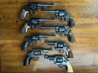

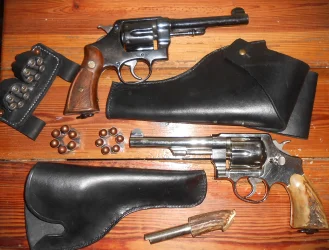

Here is a bit of quirky for the group, picked this up from a company that does a bunch of estate business for a few Benjamin's. This started out life as a 1937 production Argentine mil pistol, supposedly made on S&W equipment in S. America for their Army issue. After import into the US, someone with quite a bit of extra funds to spend ,turned this gun was turned into the FrankinSmith seen in the pictures below with :
1. Barrel cut to 4" & addition of target sites.
2. Re-parkerized (with some care I might add) and all stamping is still visible.
3. A serious trigger action, double = 4.5lbs & single + 1.1lbs + smooth as glass.
4. Added vintage S&W targets that look like new.
The gun shoots very well, tight groups as the lock up is very strong and surprisingly low recoil with standard 230gr milspec.

Would I modify a 1917 to match yours? No. Would I buy yours in a new york second? Absolutely! Might even pay a premium for it!
That is very very cool!
