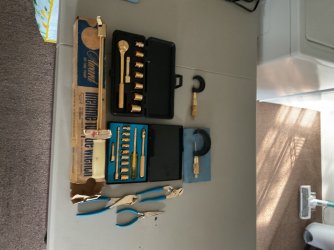

I beleive it is Starrett with a clutch for consistant force (extension knob) The model number is prob on the other side. 436 seems likely That number seems to have been retained for many years.
Thanks for that :) The gold color had me fooled as I wasn't aware Starrett had any gold-colored tools.
Last time I checked a few years ago the 436 was still available. About $140.00 IIRC. I think I made out like a bandit on mine as it is in perfect condition. Sadly, Starrett was sold to a private equity company last year :(
oldbrownhat, it's a Starrett, or else it sure looks like one. Starrett made quite a few different versions or styles of vernier-reading micrometers. I did a lot of measuring in the 0-1" range and carried my own micrometer with me, rather than using whatever was lying around. That model was common and least expensive, I believe.
Off topic a bit but I always preferred the "Slim-line" style that Starrett made, which was just a delightful tool. I don't work much with precision measuring tools these days but I still keep two of them around, my latest one "with all the bells and whistles." (Hard chromed, tenth reading, carbide faces, friction thimble, etc.) I suppose today it would be considered "obsolete," about like a .38 Special revolver. 😏
I'm an adjunct machining instructor at my local community college, and every few months a retiring machinist will drop tools they no longer need. Most of the stuff will go out in the shop for general use, but any quality precision measuring tools will get cleaned, checked out and put away in my office to get passed along to young students who show potential but are on a tight budget.
I acquired many of my own tools scouring flea markets and "antique" shops whenever we visit friends in New England. It seems everybody in that part of the country has a father/grandfather/uncle who was a machinist or tool and die maker, and their tools can be purchased for pennies on the dollar. My best bargain so far has been a virtually unused 1-3" Mitutoyo mic set for exactly zero dollars.

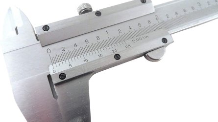

Also have calipers with the same style marking. If someone wanted to borrow one, I gave them the 'old' style. Most new guys handed them back as they didn't know how to read them.
Starrett micrometers came with either of two constant force
or torque mechanisms (or drives) or with just a plain thimble
(the mechanic relied on his/her "feel" when using the mic to
determine the proper measurement).
The OP's micrometer is one of Starrett's most popular lines of Mic's,
the 436 series. The one the OP shows has what is called a "ratchet"
thimble or drive. I prefer the other drive called a "friction thimble."
Cheers!
Webb

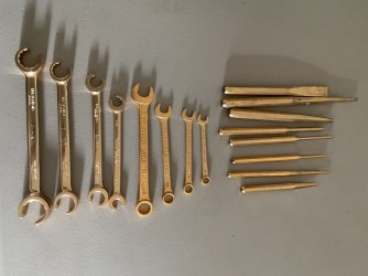

Thanks for your responses. The remainder of the MTSC tools. I use the pliers and the punches on a regular basis. All high quality. The remainder are tucked away in my tool cabinet. Interesting torque wrench.IMG_0397.jpegIMG_0398.jpeg
The markings are just like money. Each mark on the thimble is a penny. Each mark on the barrel is a quarter. 4 quarters equal a dollar. 1 thou, 25 thou, 100 thou
