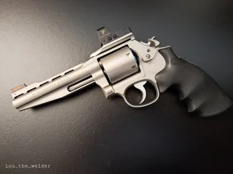

The package I had done also included a matte bluing. Picture below.
