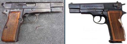

Everybody is generally correct; just to clarify one more time, here is what happened:
Starting in the 1970s, FEG, then still a state-run operation, built a single-action Hi-Power clone, called the P9. This was exported to the West and, among others, sold through Mauser as the Mauser 80SA.
In 1980, FEG decided to add a double-action version to the line, the P9R. This gun combined the cosmetic appearance of the Hi-Power (top and front end) with an action generally described as similar to the S&W 59 (rear and grip frame).
Mauser marketed this as the Mauser 90DA, and that's the gun the OP originally asked about.
The differences between the two are blatantly obvious; see attached comparison.
