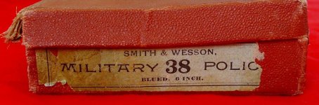

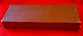

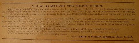

The only one I can offer is this one for a Model of 1903 2nd Change circa 1909...:o...Ben
