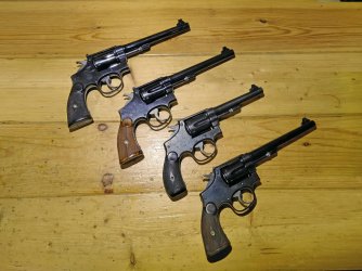

The use of engineering changes is somewhat incomplete when it comes to identifying and naming models. There were engineering changes that were ignored by Roper & McHenry, including a very important engineering change that was the design and introduction of the square butt frame. To me, that is the true introduction of the Model 1905 and was ignored by those authors. The attached photo shows 4 of the 4450 guns made in the 58,000 to 62450 range. If you saw those revolvers in a gun shop case, before you saw the serial numbers, for sale, what would you call them?
