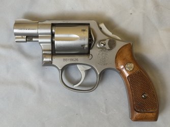

Model 64-4 NY-1 2" RB #BBY8719
#BBY8719 is one of the NY-1 guns that I don't really think was ever meant to be. This particular one was part of a 200 gun shipment on February 17, 1989; likely off of invoice #07003501.
The NY-1 'family" of guns included a Model 60 that was modified to fire DAO as an option for off-duty and plainclothes. For various reasons that this article won't address right now, the Model 60 NY-1 revolvers were withdrawn from service.
Their withdrawl from service left a large number of people high and dry. The officers who had purchased the M60 NY-1 had to now pay for a new gun while the gun they had already purchased and paid for was, administratively, useless.
The Patrolmans Benevolent Association stepped in and had their lawyers step in and threaten sue S&W on behalf of the men with the now useless revolvers. Under terms of an agreement, S&W would either refund the cost of the gun to the officer OR provide them with 2-inch RB M64 and a $35 coupon.
Known 2-inch guns number a bit under 600 and, given the incomplete records, may number a bit higher. They are not too common.
The sample shown here has a significantly more subdued finish than the very early gun, AWT2968. Also, the gun has the stamped 2nd serial number placement under the left frames cylinder window but lacks the third serial number on the cylinder yoke cut-out.

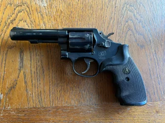

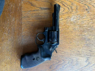

I thought the classic 10-8 SB 4" Heavy Barrel, which was a former NYPD duty weapon had history and provenance to it. Thanks for sharing that much information on the classic wheelguns.

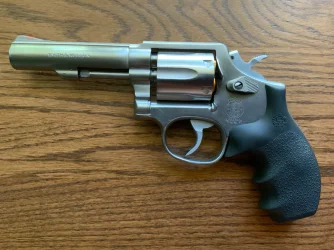

I have a M64 4" RB serial # AWH8324, marked NY-1. It appears after NYPD service someone replaced the hammer and trigger, and it cocks in single action. Whoever did the replacement did a rotten job because the trigger pull had such a bad hitch that I sent it to TK Custom, and it now finctions well.
It does not appear the gun was fired much. Compared to my LAPD-issue M67 that I carried from 1981 to about 1985 or 86, the NY-1 gun looks pristine.
