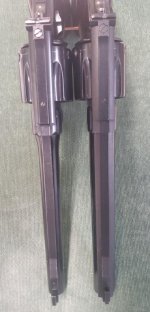

The difference in the barrel profiles (and consequently the revolvers' weights) make the shooting characteristics very different. I prefer the model 1950, but they are both great shooters.

The difference in the barrel profiles (and consequently the revolvers' weight) make the shooting characteristics very different by comparison. I prefer the model 1950, bit they are booth great shooters
The overhead shot definitely shows the profile difference. I have resisted taking a similar image of mine out of respect for your idea.
Kevin
Kevin
I appreciate that, but don't let that stop you. Chances are good that you're a better photographer than l am. LOL.
