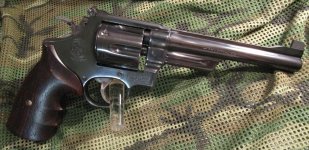

The red ramp is correct. I based my comment about it being added to the revolver later on appearance of the two pins securing the ramp base to the barrel. The pins look like they were removed and replaced by someone other than S&W.

Im a little late to the party and see the thread has drifted a tad but after rereading this thread on the OP's gun this comment caught my interest, prior to around 1980 target frames had grooves cut into the rear sight channel just ahead of the rear sight, that is except for the Model 28 which was smooth and the Model 27 which was checkered.
It would seem that if the OP's frame began life as a HP it would be smooth there, I would doubt that if the factory converted it from a Model 28 frame they would go through this extra step, if it was converted outside the factory theres even less chance.
To satisfy my personal curiosity I would love to see a pic looking down from above showing if the frame has these grooves, if the frame has grooves I doubt it began life as a HP frame IMO.
