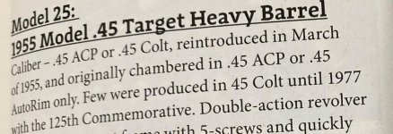

My copy of the Standard Catalog of S&W (4th edition) says a few were originally chambered for 45 Colt. I have a M25-2 with both cylinders so mine will fire either one - very accurately!

SCSW mentions that very few M25's were made in .45C until 1977, when the 125th Anniversary -3 and -4 were marketed. I suppose .45C could have been special ordered, and I'd say they would be rare and desirable collectibles. The -5 was the first non-commemorative M25 chambered for .45C. The -3 and -4 are "short cylinder" .45C.
