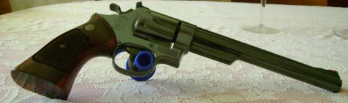

I cannot help myself
when it comes to choosing old firearms over the new models, the old ones seem to win out almost every time. Like a new condition 29-2!
    80.7 KB
    102.4 KB
