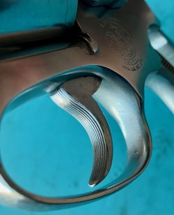

I absolutely despise the grooved triggers on most Model 36’s. They are very uncomfortable and often too narrow. If you have a local gun smith that knows how to do the job then your best bet is to give them a call and have them order and install a better trigger. There are plenty out there.

I hate grooved triggers and find them to be a solution in search of a problem. Since this is a serious use gun from your description, there are two choices. One is to find a factory smooth trigger. I am not very familiar with what is available for a J frame as I don't like them very much. The other is to find a decent machinist to grind those grooves off and make everything smooth. Remember that modifications for function are vital - collector considerations are not and should never interfere with serious use.

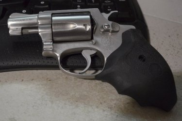

I took a dremel to this old model 60. It isn't pretty, but it was a major improvement in feel. Basically, broke all the sharp edges. If you've got the skills, you could make yours a lot nicer/smoother looking.
Smithman 10, I've bought many hammers, triggers and other revolver small parts from USA GUNS AND GEAR, as well as Jack First Inc and The Gun Garage.
If you contact them with your model # (36-1, 36-3, etc) and serial number they can get you a correct and complete smooth combat trigger to fit your revolver. If you're not comfortable swapping it yourself it should be quick work for a gunsmith.
I would not suggest the part from Numrich's shown above (no offense b737lvr) because it doesn't include the pins, rebound lever or spring. More parts to buy and work for the smith.
Might be worth it to take the gun to a smith and ask them to polish off the groves and any other uncomfortable parts of the trigger. I don’t know what it will cost but guessing it will likely set you back at least $200. I had the grooves on a target trigger on a K frame removed years ago, and the shop also “radiused” the trigger, which got rid of the sharp edges on the back side too.
