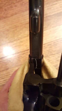

Unfired 37-1 3", 99%+ not even a turn line. My FIL bought new, it was heartbreaking to discover the cracked frame.
If unfired, would that mean the crack was caused by barrel installation and it left the factory that way?
I really don't believe it was like that when new. I would be certain he would have noticed as he was a S&W collector and an engineer. The contrast from the black finish to the raw aluminum really made the crack stand out. I would imagine the alloy, barrel torque and thread stretch caused it to crack. In fitting the barrel I would guess there is a range in the torque specs when clocking it and this was at the limit. Any thoughts?

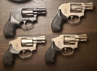

All four of these J-frames track to 1993 based on serial numbers. The 38 and two of the 442s are in satin-nickel, which was only available for a few years in the early to mid 90's. The two satin-nickel 442s serial numbers are 64 digits apart and were bought within the last couple years about 120 miles away from each other. One was bought at a gun show in Lebanon, TN and the other was bought at a gun shop in Huntsville, AL.
