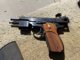

I was at the range yesterday, enjoying my Model 52-2, when something fell onto my left wrist and landed on the bench:
Needless to say, this was highly unexpected. I'm shooting loads just barely powerful enough to cycle the action (3.2gr WW-231/HP-38 with Speer 148gr HBWC) and I never even use the safety.
I hopefully called S&W and they very politely informed me that they no longer support this model (I believe they have divested their entire parts inventory for all their metal semi-autos). They had zero suggestions and told me to just look on the internet.
Far from helpful.
I then reached out to Jack First who had piles of these things in both used and new formats, priced at $60 and $72 respectively.
For $12 more I happy chose the new option and the part will arrive next week. Then it's off to the gunsmith for installation.
Is this a common failure? I've never heard of it before?

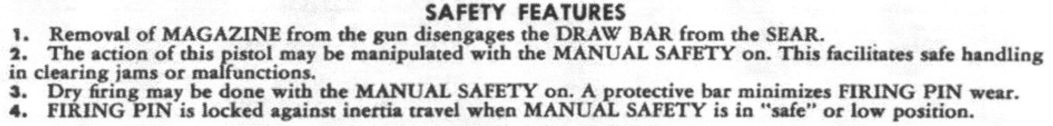

With regard to the Model 52, S&W states in the manual that the gun can be dry fired with the safety on. I'd think they knew their gun when they wrote that, but it wouldn't be the first time a manufacturer gave questionable instructions. Here's a clip from the manual. No. 3 claims it minimizes firing pin wear, but at the expense of the safety lever? We may never know for sure.

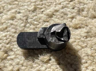

The failure in the picture appears to be a torsion failure from over twisting. The failure is also close to the operating lever. I would guess a failure do to hammer hitting would be a shear failure or a fatigue failure closer to the location of the stress.
Did you ever put a pipe wrench on the safety lever?
FWIW I only ever rotated the safety 4-5 times during my short ownership tenure. It had zero indications of anything wrong. It just acted like any other S&W auto safety with no undue resistance.
S&W might have condoned dry firing but probably didn't think about the pistols being used 50 years later.
