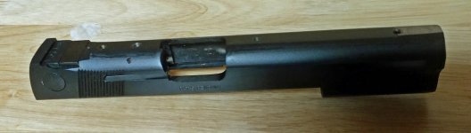

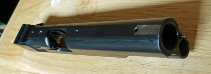

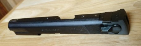

Welp, I went and picked it up today.
First thing I did when I got it home was put a couple of batteries in the vintage Aimpoint. It worked like a new one.
Next thing I did was to remove the Aimpoint and the Picatinny rail to see what was under it. That was a much bigger job than it sounds. Taking the Aimpoint off was easy enough. Just 2 screws that loosened up pretty easily. However, the 3 screws that held the Picatinny Rail on the slide were a different story all together.
The original owner who put the optics on this pistol obviously NEVER intended for them to be taken off. The screws were liberally glued in place with RED Loctite. LOTS of it. You can even see some traces of the excess on the top surface of the slide.
It took heating both the rail and the slide with a butane torch to soften up the Loctite enough to get the screws out - especially the center one. I darn near stripped it out before I finally got it loose.
Of course I was hoping against hope that the front sight would still be there fitted into a slot cut in the underside of the rail. Alas, it was not to be. Once I got all the screws out and removed the rail I found exactly what I expected underneath. The front site is gone, machined off the slide.
A pity that someone chose to do something so irreversible to such a classic gun that is otherwise in such incredible shape. It's obvious that the owner decided to make the gun into what he wanted with no intention of ever letting it go. Since it came from an estate sale I guess it is pretty safe to say that he followed through on that intention.
So, now I'm on the hunt for a new slide. Though I also intend to silver solder a front sight on this one and install the Bomar rear sight that Sevens was gracious enough to sell me.
Below are a few photos of the slide with the rail removed.

BC38: I really feel for you in this situation. I had hoped that the front sight was still in place under the rail, but not to be. I guess even at 70 years old I will never understand why people do some of the things they do to a firearm and this is just one of many of those occasions. With just a little bit of extra work they could have kept the front sight intact. If nothing else just mill a slot in the darn rail and call it good.
You may get lucky and find a decent slide for your pistol, but it will no doubt be costly. The plus side to this is that I think more 52's are being taken out service than repaired these days for lack of parts. Keep an eye on the usual sources for parts including a place called Hog Island. I have no connection with them, but they do have a ton of parts for old S&W's. If I happen to stumble on anything I will let you know. Don't buy something if you can't return it. If you find a good slide then have if properly fitted. Big gun shows are your friend in cases like this.
Rick H.
Mistaken identity! I only took measurements, I did not sell or send anything. ;)
My sincerest apologies to Kp321 - he's the one I have to thank for selling me the Bomar sight! It should be arriving soon.
Though I still want to thank Sevens too - for getting me all the front sight measurements.
