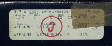

One thing I recently saw online was a 624 with a recall stamp on the label circle C in red. It was interesting in the description the owner noted that on the right side of the grip frame under the grips, along with some other stamps was a circle C also. I would say that hearing that, would indicate to me for revolvers that don't have boxes, look for a circle C on the grip frame under the grips. S&W has always had some sort of a stamp to indicate a gun has been checked or had work done by their shop. In this case it would be logical for them to stamp the circle C on the grip after the inspection done and the gun was to go out. That's certainly worth looking into, I would think.

The former owner must have sent it in (I've had it for a long time) because it has the Circle C on the box.
The circled "C" on the grip frame is on a number of S&W revolvers I have seen. It would seem not to be a record of the recall.

By the way, I determined that the "F" on the cylinder DOES NOT indicate it passed any test. It is simply a mark indicating that cylinder is for the 624. Smith didn't necessarily mark every one with an "F" but that's what it represented when they did. The ONLY indication a cylinder passed the magnaflux test is the red "C" within a red circle stamped on the box. If you didn't send in a box, you got no indication it passed, other than getting your gun back. Smith does keep a record of these so you can call and, if you get a willing cust support person, can verify pass or fail info. The guy I talked to was willing to spend the time searching paper records to help me, your experience may vary with mine.

All have the red C on the box.

If as Mr. Jinks suggests, the steel was not an issue, then why were some 629-1's recalled?
I have one of those too. 6" with a red C on the box.
