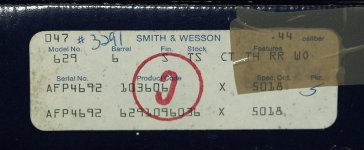

That makes me wonder how I ended up with a 6" 629 that has a big red C on the box.
Were some of them mistakenly bored for a supermagnum?
(Too bad Charter Arms doesn't keep track of this kind of stuff as I can EASILY fit a magnum into my Bulldog.
It's as if the chambers were bored specifically for a magnum instead of a special.)
