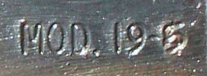

I think the "2" is stamped over the "1".
During the transition from the 66-1 to -2, it was very common for an unpinned frame to be stamped "MOD. 66-1" and when the revolver no longer had any "-1" features (ran out of recessed cylinders), they'd overstamp it a "2".
My 19-5 in the 201K range is like that too.
May be hard to see but...attached.
Parker357, is the trademark on your 66 larger than the one on my 19-5?

After closer inspection last night I realized the SN is 219K249
giving it a 1982 shipped date.
(SNW19_357) the trademark is the same size as your M19 shown above. It does have the "F" stamped 1.62" non counterbored cylinder.
