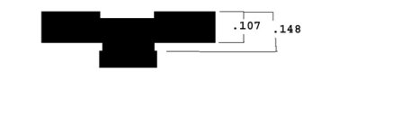

Need to replace the rear sight blade on my 1975 Model 67 4inch barrel. Does someone know what height blade was standard? I've got the old blade but don't know where to measure from. I'm thinking .136 but would like to know for sure. Thanks, Dave
Looks like the sizes listed on the Midway site may be the width of the notch, not the height of the sight. Any confirmation?
S/be size .146 - the blade is measured at the end, from top to bottom. Ignore the notch, they are all the same.
Apologies for the late response (been out of town). I had the same question a year ago (Model 67, no dash, 4" barrel) and contacted S&W. Mark Rossini of S&W responded that a .106 height was correct. That's a bit different from your other response. If you have installed a .146, I'd be curious to know if it shoots correctly.
Thanks for the replys. Haven't ordered yet but think I'll go with the .106 blade. I was able to match measurements of my blade with reponses. The measurements of the attached are what I came up with.
Thanks for the help. Dave
