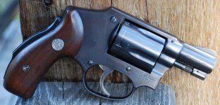

I saw a M-940 the other day, could be only the second one I've seen. I ask you if anyone feels that it has an advantage over it's twin the M-640-1 that will shoot both the 38 Special and the .357 Magnum? Oh yes, I think I know the answer. The added steps having to load the moon clips and the step to remove the empty cases from the moon clips after do not seem to present any advantage to me. Only 5 shots also subtracts from it's desirability but all this is me trying to talk myself out of being tempted to make another purchase. Any opinions either pro or con and what should it be worth with original box, three moon clips & paper work, saw no cleaning accessories?

I own two. a 940 and a 940-1. I bought them both cheap years ago while S&W still made them, but they weren't yet popular. I have pictures here somewhere.
