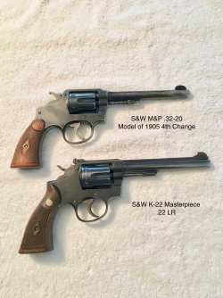

Here's my .32-20 M&P (1905 4th Change), s/n 118705 (ca. 1923) for reference.
