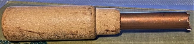

There are three different unloaders in this picture. My preference are the tubular unloaders and you can make them with suitable diameter steel tubing and a hack saw or grinder. If you have a lathe or access to someone with a lathe you can knurl the handle end in no time and make it look pretty as well as easier to use.
/QUOTE]
This one I made out of a copper pipe and a wooden handle for a file I had laying around. Helps to keep stuff (wife says I am a packrat). Works for me.

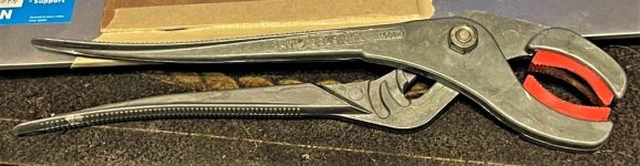

We called these Cannon Plug pliers when I was an electrician on aircraft. Will have to try them out. Padded jaws may be good!
BMT
