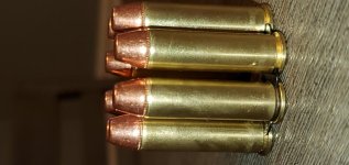

I have been reloading my 357 rounds using HP 38 and Titegroup but recently switched to Winchester 296 after reading how well it worked for 357 Magnum. I loaded Winchester once fired brass with 158 gr. Extreme copper plated flat nose bullets , CCI 550 Magnum Small Pistol Primers and 15.7 gr. of 296 powder (Max load listed as 16 gr. on Hornady reloading app.) with a C.O.L. of 1.58 and what I believe is a medium crimp I am including a photo for others to give their opinion? When I went to the range I was surprised by the muzzle flash and was a little concerned since I have not experienced it before with reloads or factory ammo. I inspected the gun and found nothing to appear to be damaged. The 16 rounds I fired all were accurate at 15 yards so no problem there. Just looking for some reassurance that this is relatively normal or advice otherwise. Firearm is a S&W 627 Pro Series 4" barrel

Have you ever shot full power factory 357 in your revos? The previous piwders you are using produce solid midrange loads & because they are quite fast, less blast & flash.
You have made some incorrect reloading assumptions though. Plated bullets are NOT jacketed, so bullets arent plug & play. A plared bullet is a lead bullet with thin plating. They actually load between a lead bullet & jacketed. If you arent getting stcky cases, you are probably fine.
Magnum loads of Magnum powder in a 4" barreled revolver equals large muzzle flash. If that is the only "symptom", just don't shoot at night... :rolleyes:
Flash with the slow burning powders in shorter barrels is quite common - due to unburned powder getting some fresh air to burn in.
It's normal ...the slower the burning rate and shorter the barrel the bigger the fireball .

Thank You to all who responded! This was very helpful and I am more comfortable now knowing that this is a relatively normal occurrence with 296 and I am not at risk of damaging my firearm. Thanks again to you all.
