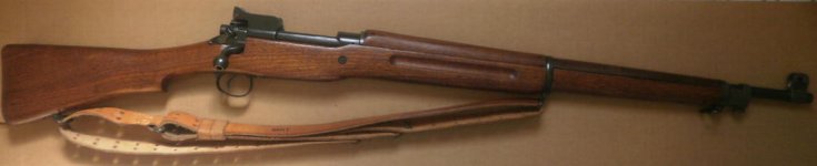

My first M1917 Enfield
These are excellent shooting rifles! And yours has a really nice looking set of wood on it.
This one (Winchester) went thru a rebuild at one time but judging from the blue on the barrel and receiver I doubt it spent any time in the trenches.
True but conspicuously refinished. Due to their rush rush manufacture sanding stopped at a coarse grit.

Yea, probably a refinished stock but they left all the stamps in place, nice and sharp edged. The day before I picked it up someone on the local forum listed a bayonet and scabbard for it. The bayonet is the more seldom seen 1918 stamp and the scabbard, I believe, is the British issued model. From my reading, these bayonets were reissued to the British in early WWII and they used their scabbards (1907) instead of ours so they would work with their belts. I paid $60 for the bayonet and scabbard and less than $500 for the Enfield.

As with most military rifles, these went through Arsenal rebuild and they didn't worry about putting the correct parts back on. The front bayonet lug band is a parkerized Eddystone, stamped with an E. The middle band is a Winchester, stamped with a W with an Eddystone swivel. From what I've read the Winchesters had better blue, and this middle band shows. So mines not 100% matching, if so I could probably double my money on it. But the main parts are Remington and I got it for a bargain price so I'm thrilled with it. Now to just get out and shoot it!
