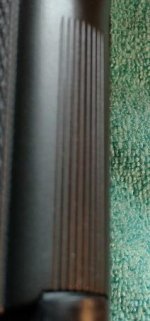

This is my 1911 Colt Combat Government Series 70 (originally built in 1983 in very limited numbers) that Novak's customized in 2008, 70B425XX. It now has a 5” Nighthawk Custom match barrel/bushing/link in 45ACP. Originally, all Novak's did to improve accuracy was put a match bushing on the factory barrel. I was never a fan of that approach since accuracy was at best marginal and a properly installed match barrel is every bit as reliable as the factory barrel. However, the rest of the gun is first rate all the way, typical of a Novak Custom. It has Birdsong's Black-T finish, VZ grips, an 18# ISMI recoil spring, Novak's tool steel Commander hammer/sear/disconnector, Wilson beavertail grip safety, beveled magazine well, long trigger and serrations front and back. The serrations were factory on the Combat Government. While at Nighthawk Custom for the barrel work I also had them install a tritium front sight and one of their strong side thumb safeties, which of all safeties on the market today fit my hand the best. This is purely a working gun. Everything I need and nothing I don't. As soon as my order arrives from Ahrends I'm replacing the VZ grips with another set of their Classic Combats in checkered Makassar Ebony.
