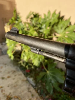

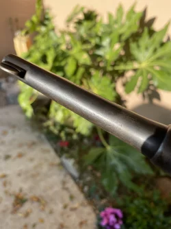

I believe it is a late production 1948 5" M&P 38 Special 5-screw revolver. SN S967XXX. I can't seem to find a barrel that has the half moon front sight and no offset cut for a large ejector rod end. It's either a serrated front sight with no offset, or a half moon front sight with an offset. I'm even open to having the barrel repaired, but I'm guessing barrel repair is not really a thing.
Welcome to the Forum. Personally, I would not worry about the barrel on that particular revolver. It has been well worn and looks like a parkerized finish has been applied. It will still shoot accurately, so that is not a reason to replace the barrel. If inherited, the bulge was probably put there by your ancestor and they proceeded to shoot the heck out of it after that barrel incident occurred. Value-wise, you will likely not get the cost of repair out of it and finding another parkerized barrel that comes close to matching your frame finish will be impossible. Once your other issues are remedied, I would not be at all concerned about that slight barrel bulge.
Barrels show up on eBay occasionally. A Want to Buy ad here on the Classified section might find one too. That said, I agree with Rpg, unless there's more wrong than we can see, I'd leave it as it is. From a sentimental value perspective I'd keep it as I got it too, other than whatever tweaking might be needed to make it functionally ok.

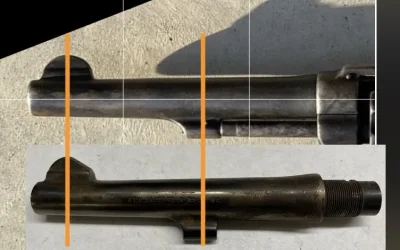

The odd angle of the photos makes it difficult to be certain, but it looks like a 6" barrel to me.
Haven't measured it. Based the 5" assumption on barrels I see online and how the sight/extractor rod detent area lines up. I'll measure that later too.
6" Looks like the front sight is much further from the extractor detent area for me.

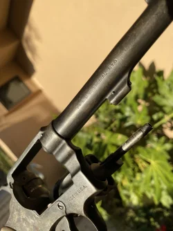

What’s up with that side plate?
If you’re just looking for a challenge, or something to practice on, ok, I get it. But if you’re looking for something to actually shoot, I’d move on.
Screws that were on the revolver were garbage. I've since replaced them and the side plate sits better now.

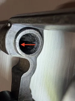

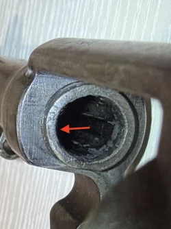

Hard to show in pics, but here is the forcing cone damage.
Compared to the other side.

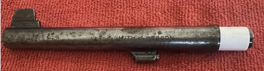

I have my eye on this barrel on eBay…
5” and similar patina. Front sight isn’t the same though; I think this is from a newer model. Just asking for help looking for the same style barrel. I’m thinking it was only made from ‘46-‘48, so not that common.
You could also just chamfer the forcing cone, assuming you can live with the barrel bulge.
Safety is really the concern. If a bulging barrel only impacts accuracy but it’s safe to shoot, I’m good.
There was some side to side yoke/frame play which I think was the reason for the out of time/forcing cone damage. Did a little yoke adjustment and now there is no play sideways. Looking down the barrel, looks well timed too. So I’m not sure if the forcing cone damage would be a safety issue at this point.
