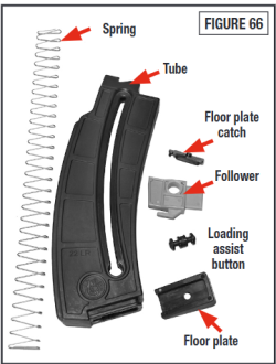

A few months ago i decided to give a deep clean. cleaned the rifle well so decided to give the mags a clean too. first mag stripped down well and gave it a good clean. however when i went to strip the second mag, the little plastic thing at the bottom flew off into a blackhole!!! i looked everywhere for it. cannot find it at all. roped the mrs to helping me look again and we came with nothing.

can anyone help me out to get some and then ship it to me in the uk. Obviously i will pay postage. just got a mag sat there now that i cant use and dont really want to buy another mag just for that little piece. piece in question is that little piece that you depress so you can slide the bottom off.

Use the existing one as a pattern, A piece of plastic, wood, metal and short screw or dowl rod and superglue. It's 15 minutes at the kitchen table. It dose not need to be perfect. No one will see it.
I think that this is your best bet if you have a file and a piece of scrap plastic or wood laying around. Use one from another magazine as a pattern and take your time. It probably doesn't even have to look exactly like the pattern, just be close enough to function. You have nothing to lose except for some time. Good luck and let us know how you make out.
Why couldn't you just slide the floor plate on without the catch?
If the floor plate wants to come off, put a piece of tape on it. Might not look too good, but I bet it would work.
I just shot 100 rounds without the floor plate catch. The floor plate did not slide off easily even without the catch. 100% reliability.
If you want to retain the floor plate, push a thumb tack through the bottom of floor plate. it will catch on the spring and prevent the floor plate from sliding off. 2 minute fix.
If you need the clean the mag again, use a flat blade screwdriver to pry out the thumbtack.
Cut and file a flat piece of plastic or metal to fit like the OEM part, then drill a hole in the right spot and put a suitably sized self tapping screw in it thru the magazine floor plate hole.
