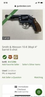

I picked up the gun today from my FFL. It is a gun that has seen it's share of holster time and life on the street. I can relate as my duty guns had wear and got banged around. I look forward to having it customized to fit my tastes.
He is my project gun. I cleaned it up with some copper scrubbing pad and steel wool (both with oil) on the few rust/pit areas. I then used Simichrome to clean the whole gun. I put Ren Wax on and buffed it. The gun is a great platform for the chop job.
I ordered a set of used Pachmayr compact grips and will bob the hammer. I have a couple of Millett dovetail front sights in my gun box. I will ask the gunsmith if these have the same dovetail as a common sight (like a 1911). I might use one as my sight blank to determine height.

4" round butt model 10............ I'd keep it a 4" gun ....... rebuild as necessary and reblue.........
Second look...looks like it's a nice shooter grade gun... just clean it up and get some new grips!!!!!
This will be my carry gun, replacing my 2" model 15-3. The gun will carry IWB nicer as a 3" than a 4". When I sit down, the 4" barrel prints out the bottom.

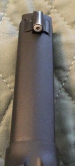

I ordered a new-old-stock DAO hammer from ebay and installed a Wilson spring kit (14#). I ordered a .170" NOVAK dovetail front sight from amazon for $14 and will give it a whirl to see where it impacts with the 3" chopped/slab sided barrel its going to get. The original sight was .165" tall.
