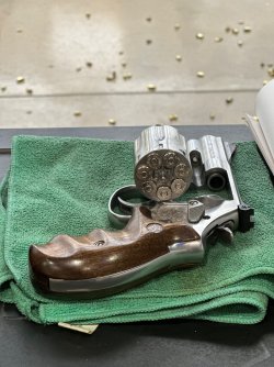

You didn’t happen to order these from PSA did you?Purchased two 686+'s in March. Neither with fire a full cylinder without the cylinder locking in place or the hammer not being able to be fully pulled to the rear. In looking at the guns the extractor "star" does not have the "fingers" that rotate the cylinder are cut the with the same profile, and some of the surfaces have cuttings hanging of the rear of the extractor and probably rubbing the frame. Anybody have any machining issues with the new revolvers? Looks like the cutting bit was dull and did more scraping than cutting. I will be calling Smith this morning about the needed warranty work.

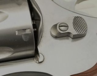

It looks normal to me, too, in regard to their standard brushed stainless finish. It's been that way for quite a few years, now.I’ve owned a number of stainless Smiths over the years and never had one that looked all scratched up like this one.

Looks to me like the ratchets are all different dimensions. I would imagine this is causing the bolt to lock the cylinder before the hammer can engage the sear, thus the cylinder and ratchet blocks the hand, stopping any additional movement of the trigger and hammer. No bueno for sure. Yikes!Pic's attached. There were two of us shooting the revolvers, both have been shooting over fifty years and have owned many S&W revolvers. The issues were the same for both of us. The ammo was winchester 38 spl+P. The first gun, img2727, stopped turning in two positions and the hammer would not lock to rear in a third position. The second gun, img2728, always stopped turning at the same position as shown in red.
I haven't owned revolvers as long as a lot of folks here, but for the 35+ years that we've had them in our family, I've never seen a stainless Smith (aside from the bead blast ones) that didn't look like they were "brushed" with a Swiss army knife. I just don't know what people like about the brushed finish...if you want it matte, then bead blast it. If you want it shiny, then polish it. I don't get the "shiny with scratches all over it" appeal, but evidently, I'm in the minority of folks who feel that way.“Brushed finish”?
Looks more like a blemished finish to me. I saw a new 686 at the LGS. I asked the counter guy why the used 686 had a new tag on it. It looked way worse than my old dash four.

Nope, I’ve never seen a “brushed finish” that looked like random scratches all over the gun. None of my other stainless Smiths were bead blasted yet they all had a smooth finish. This one looks like someone held it up to the brush wheel on a bench grinder and “polished” it with that.It looks normal to me, too, in regard to their standard brushed stainless finish. It's been that way for quite a few years, now.
Here’s a 629 off of Gunbroker. Doesn’t look at all like mine.I haven't owned revolvers as long as a lot of folks here, but for the 35+ years that we've had them in our family, I've never seen a stainless Smith (aside from the bead blast ones) that didn't look like they were "brushed" with a Swiss army knife. I just don't know what people like about the brushed finish...if you want it matte, then bead blast it. If you want it shiny, then polish it. I don't get the "shiny with scratches all over it" appeal, but evidently, I'm in the minority of folks who feel that way.![]()

Whatever. My experience with Stainless Smiths goes back more than 35 years and I know how poorly the finish on the current version compares with the earlier ones I’ve owned. But you do you.That’s a blurry, 160kb photo in dim lighting that looks like it may even have come from a stock photo…how on earth can you see what it does or doesn’t look like? I guarantee you, take a decent resolution, in-focus shot of that same gun in good lighting and it will look like your revolver’s long lost twin.
