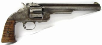

Hi There,
As the title says, I recently received a early 1st. Model No. 3
and I would like to share it with you.
This one is a Veteran of the Indian Wars period of the great wes-
tern expansion. According to the Factory letter, this one was
originally a blue one but now sports a nice nickel finish (as
you can see). Under the left grip panel are two dates attesting
to returns made in 8 . 14 and 12 24. I assume it was during
one of these returns that the revolver was refinished in nickel.
Here are some pics for you to look at.
Cheers!
Webb

Inspector Marks?
Webb,
Does your US example still have inspector marks? There should be 6 stamps. 3 Ainsworth and 3 inspector P. 2 on the cylinder.
My example shown has matching assembly numbers on frame, cyl, barrel, and latch. They do not match the serial number, begin with a letter, and mine is in the late 13xx number range.
I suspect yours was a late Militia issued gun but why it went back to the factory twice I have no idea.

Hi There,
It is my understanding that guns sent back to the Factory had
their serial number stamped on the major parts to prevent loss
and keep thing together (if those parts didn't already have ser-
ial numbers).
The assembly/fitting numbers are unclear at this point. There
doesn't appear to be an assembly code on the frame. The in-
spector stamps, the "P"roof and "A"insworth stamps unfortunately
have been polished off.
The grip panels have been swapped with SN 2012 (which is on
the list of revolvers sold to the Government) so, maybe an
armory replacement.
Cheers!
Webb
