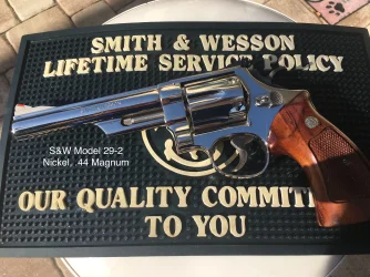

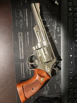

Just picked up my first nickel pistol I have ever owned. Bought here local, an eye popper. To remove the smudge where the stocks left on the frame, use semi-chrome?

If the stocks left a mark, removing it will only thin the nickel and the mark will be back. Unless you relieve the stocks slightly. Leave it alone since the stocks cover it.
I use Mother's Mag Polish and a very soft cloth.

Mother's Mag Wheel Polish or SemiChrome Paste, either one and a very soft cloth, flannel or microfiber, and polish gently by hand. You may not completely rid the finish of those marks, but I think you can certainly make them better. Once finished, Renaissance Wax works great to protect nickel finishes.
