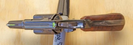

Just picked up a very nice, tight 2" Model 36. It has what appear to be factory stocks but they do not number to the gun. Has some florescent yellow paint on the sights and a turn ring but virtually no blue wear on the muzzle or cylinder front edge. It does, however, have significant blue wear on the butt and the back strap. Serial # J9538XX. If I shoot it much I will probably have to have the b/c gap adjusted as you can barely see daylight between the forcing cone and the front of the cylinder. I will try to take a photo in the next day or two when it isn't so bloody hot.

Yes, it does need a B/C gap adjustment. Going in to the smith today. Also I took the paint off the rear sight. Having both the front and rear the same rather garish color did NOT help sight picture acquisition.
