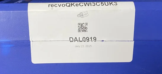

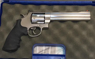

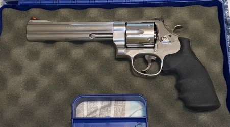

Hello everyone, I am brand new here to the forum as I am a brand new adopted father of a 629 Classic. I have wanted this revolver since I was 12 years old. I am 52 now so it's been a long wait, but I digress. I was wondering if anyone could provide any info on my "new to me" pistol. The number behind the cylinder is DAL0919. The pistol is a 629 Classic .44 Mag. I can attach a picture if needed. Thank you in advance for your assistance!
Congratulations on an excellent choice of your new to you 629 Classic. I'm sure someone will be able to give you an idea about how old your revolver is. You can check on the frame under the yoke, it should give you the engineering changes i.e. 629-? but I believe the Classics all had the endurance package, essentially, an upgrade for shooting heavier loads, as I recall. They also produced the Classic DX, with extra features, such as several replacement front sight blades, morado wood grips and Hogue grips made for Smith and Wesson, the revolvers were tested for accuracy and the test target was included. I found that the standard Classic model was more accurate than I can shoot it. I hope that you enjoy your new acquisition and get back to us with a range report and people here have a special place in their hearts for photos. By the way, a hearty welcome to the forum from San Diego!
Hmmm, I don't see DAL listed as examples known to have shipped, but some DAJ and DAK shipped in 2006, and DAK again in 2008.
They list the 629 .44 Classic Stainless and the .44 Classic DX (Deluxe) Stainless just to muddy the waters a bit. A pic or two can help. If it has the box the end label can tell us quite a bit.

Thank you guys so much for responding so quickly. Here are some pics

Product code 163638 with internal lock shipped 2002 to current date.
O6 6 shot 2004
A2 single action/double action 2004
LG large frame size 2004
GR rubber grips
BF full lug barrel 2004
SA adjustable sights
SW white outline adjustable rear sight 2004
FS stainless frame 2004
CS stainless cylinder 2004
ZS satin stainless finish

If I have understood correctly from lurking around here for a while, the 6307 on the label means that your 629 was shipped from S&W on the 307th day of 2006.
If I'm mistaken, I'm sure someone will come along and correct me.
I know that's true with the number in the "Spec Order" box on earlier labels, but I'm not sure about these newer ones. It makes sense though, good call.
