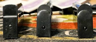

The two mags came in this morning, Look good. Some minor differences in construction. Fit tight, when I try to eject them I have to get a fingernail on the floorplate and pull down. Need a firm push to set the mag fully. Tried feeding with an empty case and both mags did so as well as a original 52 mag. Both locked the slide to the rear when I ejected the chambered case. I figure to shoot them next Friday. Will see if they wear in for seating the mag and ejecting the mag. Some oil may help as the mags are bone dry. Overall impression is good.

Just a picture so just what I can see or think I can see (NOT an indictment!) but first photo, magazine on the far right, where the spring meets the underside of the follower...
...this looks like rust or corrosion? Must just be an odd reflection captured in the photo. But maybe get eyeballs up in there and make sure there's nothing ugly.
