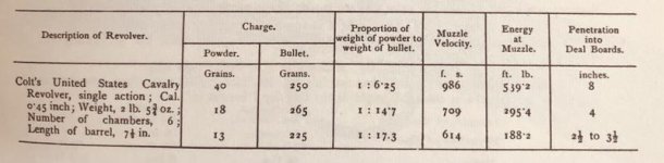

Welcome to the forum,
I’m not sure where you are getting your performance on the 45 Colt black powder round from? Please post your source.
I have the original Military trials documented from the early 1870’s when Colt was competing with other gun makers for the contract of pistols for the military. The original load during the trials was a duplex load totaling 40 grains. Later commercial loads would be FFG. However during the trials they were using an “experimental load” of FFFG with a possible primer load of FFFFG to heat up the round for the trials and impress the generals.
If you look at the photo posted? You’ll notice the max FPS listed by the military was 986 with 539 foot pounds of energy.
That’s the MAX READING FROM AN EXPERIMENTAL LOAD. They also later determined that this load was TOO HOT and replaced it with a common sense FFG load which brought the performance down to realistic and sustainable readings.
Also, PRESSURE SPIKES, can not be avoided using smokeless powder unless you clean the gun after every shot. Any obstruction can and actually does cause a spike in pressure. Modern guns can handle this but antiques can’t without eventual damage.
It’s not about the time pressure curve, or the formula, it’s about changes that occur from shooting any gun that involves fouling, residue, leading, and any form of obstruction. Smokeless or “nitro” powder doesn’t appreciate it and responds aggressively to any form of obstruction or delay in the bullet leaving the bore.
I can’t explain it any clearer than that. A time/pressure curve is meaningless using “nitro powder” when any form of obstruction is introduced. Often with antiques it’s as simple as corrosion in the 130 year old antique black powder bore. Rust and scum that has developed over a long period of time. “That’s an obstruction”!! It only gets worse from there.
Murph
