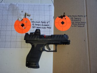

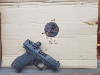

I seriously doubt I will buy any other FS/HG other than a Walther PDP and actually am planning on buying a FS 18+1 5" PDP just for fun and as a backpack/hiking gun in non bear areas.
Picture on the left is my first two mags at 15 yards after I got the RMR sighted off sandbags in the picture on the right are targets from my second ever trip to the range with the PDP/C.
