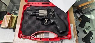

About a year ago I read a Lucky Gunner article about the 386 series of scandium L-frames. Since then I've been looking for one of the black ones (the Nightguard or PD versions) but they never show up for sale. I believe they were only made for about 5 or 6 years in the early 2000's and never sold that well.
Last week I was able to purchase a 386PD version in very good condition from forum member CH4. He was great to work with and very communicative with myself and my LGS/FFL.
After work yesterday I swung by the LGS and picked it up. I was not dissappointed!
This thing weighs 17.5 oz compared to my 36+ oz 686. They're not kidding with the "AirLite" moniker. After completing the transfer I headed for the range, swinging by the house to grab my son and my 686-6 three inch.
