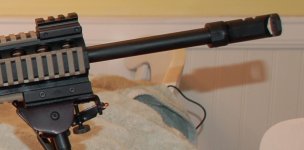

File a small flat on the bottom of the barrel for the set screw to bite into and put BLUE LocTite on the screw and the barrel and it will never accidentally come off.

Majorlk, that brake looks awesome.
The other company has only one style of flash hider, it's not a muzzle brake. And the set screws are tiny and stick out a dit. Not to slam them, just my observation.
My adapters concentricity runs within .002 TIR which is better than any suppressor I have seen. The biggest factor is if the bore is in the center of the barrel. Many people have used a suppressor on my adapter with no problem at all, and a couple could not.

The TS brake I have does make a noticeable difference. I think that comes from the fact it's actually designed for pistol use. I will admit it's a dog to clean if you let it go more than a thousand rounds, or so.
To keep legal here, I used J-B Weld to mate the brake with your adaptor, so the two cannot be separated, leaving me with an illegal exposed threaded barrel. I filed a small grove in the bottom of the barrel for the set screw so the adaptor can't slide forward, even if loose. BLUE LocTite on the screw and a bead on the barrel has made for a solid installation.
