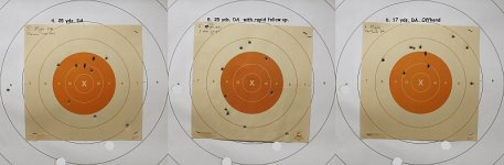

Is this with factory ammo?
Yes. First was a box of Ammo Inc 158 grn MJ, after that mostly Fiocchi 158 gn FMJ. Also ran some Browning 130 gr., Rem 158 gr LRN, Hornady 110 gr FTX to compare POI.
Point of Aim was target center.
The 110 FTX grouped low.

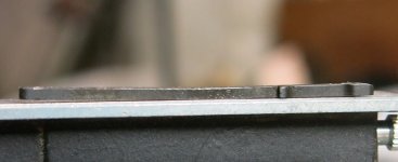

How about the hammer spring's strut?

Hammer Spring Strut: See the photo in my previous post? It sure looks bent. Perhaps a clue someone was in there before me and leaned or pried on it??
Could that be pushing the hammer to one side?

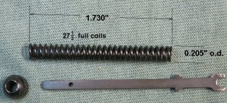

Main Spring Dimensions:
I count 27 1/2 full coils. Photo below so others can check my counting. For calculating spring rate, active coils are based on total coils less end coils. But if someone has a factory spring they can check for total coils and if the end finish matches, that would be really helpful.
Free Length = 1.730", Coil Outer Dia. = 0.205", Wir eDia. = 0.033"
Measurements are with a cheap dial caliper so plus minus .001"
a. Bent in middle.
b. Yoke is rounded over with a bevel on the side which is bent inward. Could it be so soft that it is wear? Or someone's filing?
The bent strut is not helping anything. It needs to be flattened out. It is part of the problem, but no telling what percentage. Possibly a low percent.
Fair enough. Thank you.
It was softer than I expected. Its flat now and the corners light stoned.
