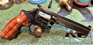

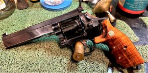

I too have a PPC revolver that'll eat anything . I don't know who built it , but he was a h*** of a gunsmith . The trigger is smooth as butter and its accuracy is top notch . I've let a couple of guys shoot it and they all come away with smiles and offers to buy it .
Now that is a nice build. I am guessing its a Model 64? Or maybe a hard chromed Model 10.
