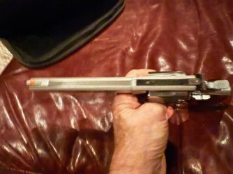

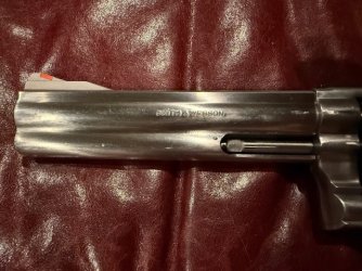

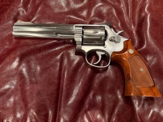

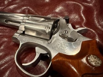

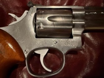

48
You can see the kind of surface I’m dealing with in the photos even though they appear worse here than just eyeballing. Just looks like its’s been rubbed out with something course.
I’ve read here or elsewhere that Flitz was a good way to refresh stainless. Thoughts?
And just use soft flannel?
Appreciate any insight!

If you are very meticulous, 3M brand pads can replicate the "brushed" finish from the factory, while removing minor scratches, etc. These pads come in different grades, depending on the finish you desire.
For polishing, Mother's Mag, Semichrome, or Flitz work fine. Keep in mind these polishes will remove the original factory brushed look.
Carter
Mother's Mag Wheel Polish, Semichrome paste, and Flitz are polishing pastes and contain a fine abrasive. They will polish, as in soften and create a smoother surface than the factory surface. To recreate the factory surface, the gray color Scotchbrite pads do an excellent job, just follow the "grain" pattern, which is longitudinal on the barrel and frame, circumferential on the cylinder.
Metal polishes will change the appearance to a brighter shine, altering the factory grained finish.
While you can use metal polishes to get a bright shine it'll never be a true factory mirror polish because metal polishes can't remove irregularities left by factory polishing.
To do that you have to use actual abrasives.
To clean up and restore the factory look, Scotchbrite abrasive polishing pads are best.
Pick a grade that most closely matches the factory finish, usually the Gray pad is best.
Buy Scotchbrite pads from auto supply houses that sell car painting supplies or from Amazon.
