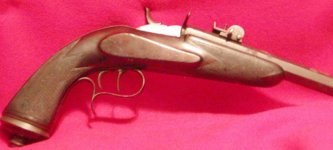

A friend runs the local gun shop. He took in a old target pistol in trade. It appears to be a copy of a Remington Rolling Block. It has double set triggers, the barrel is 9 3/4 inches long, has adjustable sights (the front is windage adjustable and the rear is elevation adjustable) and the stock appears to be walnut. We are guessing it is chambered for .44 Russian (barrel is 44 cal and a .44 Special lacks about a 1/16 or so from chambering. The only markings I can see are a crown over JA&C; a Belgium oblisk proof mark, a British proof mark(E/LG/star); and what looks to be French (star over something-obscured by the stock). No caliber marking at all. Any guesses would be welcome or directions to a site where I could find out some info.

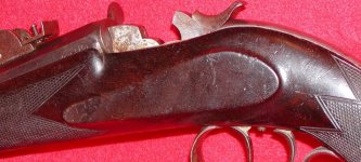

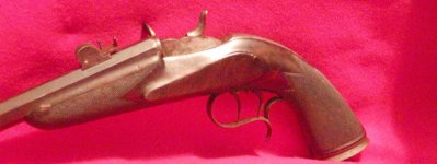

The guide that I have shows that an E/LG/* in an oval is British and is from 1811-1892 for rifles (curious for it to be on a pistol). It also shows a E/LG/* in an oval with a Crown on top as Belgium. The proof on mark on my pistol (got silly and bought it for $100)has no crown. Is the Perron taking the place of the crown?
Here are the pictures:

AJ,
I've got a catalog somewhere that shows that pistol. It may take me a little time to find it however.:D
My references shows the E/LG/star in an oval without a crown as Belgian black-powder proof since 1810.
I'll get back to you as soon as I find the catalog.
It looks a lot like an old Flobert rifle I had many years ago.
Even the stock looks similar.
Can't check the proofmarks because my sister's first husband ended up with it.
As said (Crown) ELG (Star) is a Belgian proof mark, as is the Perron obelisk. (Star) "something" is probably the Belgian inspector's mark.
(Crown) JA&C is likely the maker or distributor's trademark.
It's action appears to be the Flobert "rolling block" which is kind of misleading, it is not nearly as strong as a Remington. Not shootable in my book, unless for the wax bullet loads of the Gastine Renette Galleries.
AJ,
I haven't been able to find teh catalog with this piece in it. I'll kep looking.
In the meantime I see that you probably have gotten the definitive answer over on another board. in the JA & C is for a Belgian company (Ancion?)
As for it being licensed by Remington, I doubt it. Belgium (and Spain) wern't known for paying too much attention to US Patents and, besides, the Remington patents may have expired by the time this one was made.

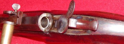

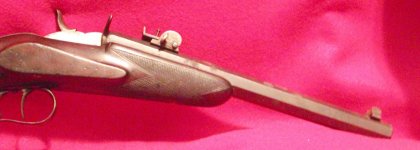

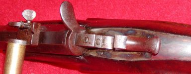

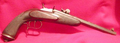

I'm not sure that the action is a very close copy of the Remington in the first place. Any chance of a couple more pictures? One with the hammer cocked and another with both the hammer cocked and the breech open.
BTW, I would have snapped that up at $100 too.:D

AJ,
Thanks for the extra pictures.
As I suspected, it is a loose copy of the Remington , but definitely not the same. Not a Flobert either. Flobert breechblocks are held closed strictly by the strength of the hammer spring. Yours is interlocked by the hammer like the Remington.
I have found several similar target pistols (or as the old Adolf Frank catalog called them "Practice Pistols for Crack Shots" :D, but can't find your exact one. One somewhat unusual feature is the .44 cal. Most of this type of pistol I have seen are in the smaller chamberings. (.22 -.32) I would guess it was made sometime around 1900, give or take 10 or so years.
I think this is a fairly decent quality gun and you got a really good price on it.
(BTW, Your picture taking skills are getting much better.:D:D)

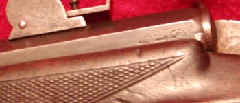

I ended up owning this pistol and researching it. Of course now I can't locate my research notes, so I will have to try to work from memory.;)
It was made by a firm named "J.A. Ancion" in Belgium probably in the 1880's or early 1890's. Ancion was one of the firms that amalgamated into Fabrique Nationale (F.N. as we know it today.)
Here are a few notes I did find:
The butt cap and trigger guard are steel and are case colored, as is the “frame” within the stock and the hammer&breechblock . The barrel appears to be browned. I cannot see any sign of bluing, even under the stock. The checkering is quite fine and all of the screw heads line up, front to back when tightened. (This seems to be a sign of a higher quality than normal)
The only other marks I have found are under the barrel marked “Mariett”.
Were this an English or American gun, I would assume this to be the barrel maker. I don’t know if this was common with Belgian guns or not.
There is also a mark that appears to be a star over what looks like a backward “P”. This mark appears on both the barrel and the frame.
In addition there are three “hash marks” on the frame and inside the stock.
Probably the stock fitters mark to keep the two parts together.
I have determined that is is most likely chambered in an old obsolete European cartridge called a .450 Long. It is also unusual to find a Target pistol of this type in such a large caliber.
I have taken a chamber cast and can fabricate cases from .45 Long Colt by shortening them and doing just a little lathe work on the head and rim.
The bore diameter is .442 groove and .427 land, with 6 groove rifling and about a 1 in 32 twist. There is no forcing cone or freebore as the chamber diameter is constant right to the start of the rifling.
This could suggest it may have been for round ball.??
(At least, that's what I'm going to try in it. I still need to find some more 45LC brass to work with. I just haven't gotten around to it.)
