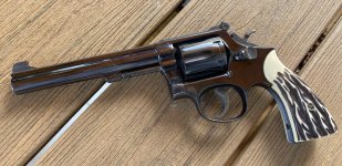

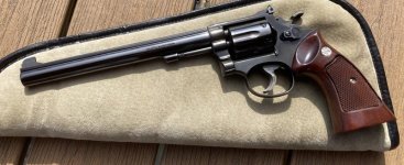

I just picked up a 99% 14-4 8-3/8's last week. I've not had a chance to shoot it thanks to rain but will have it at the range Monday. I also have a 6" 14 and the longer barrel doesn't feel any more front heavy than the 6". To me the balance feels very natural.
I owned and shot quite a bit with a 10.5" Ruger Super Blackhawk. The barrel was a little long for my needs but as far as balance it was very well balanced as well.
Edit: The grips on my 6" had to go. I need to make a new photo of it with the new target grips.
